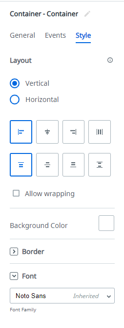

要素の配置は、成功するデザインを作成するための重要なステップです。要素の位置がきちんと揃っていることを確認してください。
[スタイル] タブで要素を横方向または縦方向に簡単に配置できます。
254
以下に、要素の例と作成手順を示します。
337
StepAction
1Open your already existing application or start a new one.
2Add a new container to your design with the following properties:
Layout: horizontal, top, left
Size: width - 100%, height - auto or blank
3Add a container inside the first one with the following properties:
Layout: horizontal, bottom, left
Size: width - 40%, height - auto or blank
4Add a label control inside the container with the following properties:
Text: Label
5Add a second label inside the container with the following properties:
Text: *
Style: color - #c2320c
6Add a new container inside the main one with the following properties:
Layout: vertical, left, top
Size: width - 60%, height: auto or blank
7Add a textbox inside the container with the following properties:
Hint text: Hint text
8Add a label inside the same container under the textbox with the following properties:
Text: This field is required
Other properties: hidden
