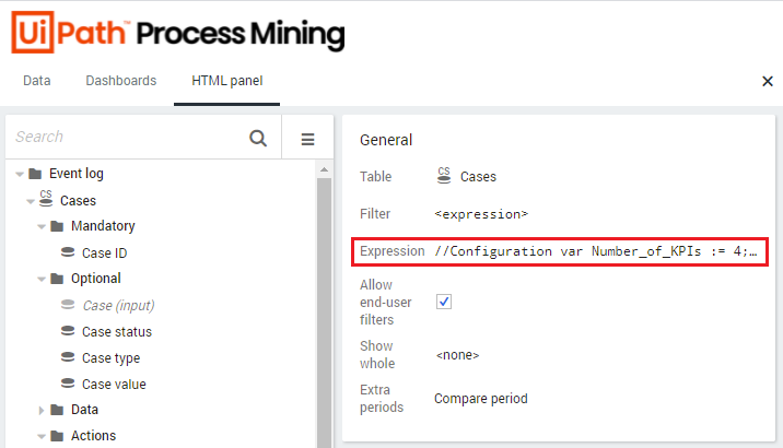

1Click on the expression in the Expression field in the General panel to edit the expression.
2Set the integer in the Number_of_KPIs variable to the number of elements you want to display in the context bar.
Siehe Abbildung unten.
716
var Number_of_KPIs          := 3;
