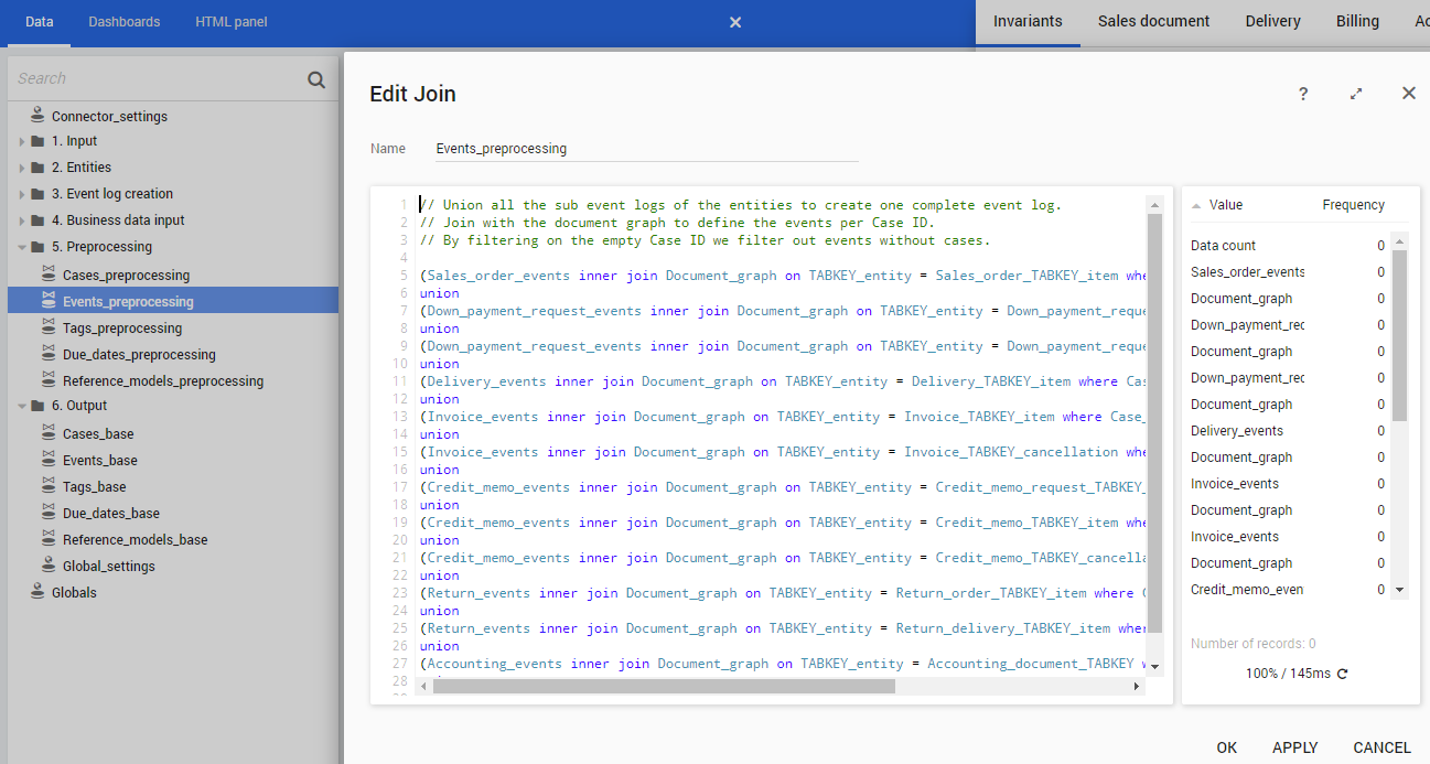

  1. Add the complete sub event log created above to the join expression of the Events_preprocessing table in the folder 5. Preprocessing. See illustration below.
1297
