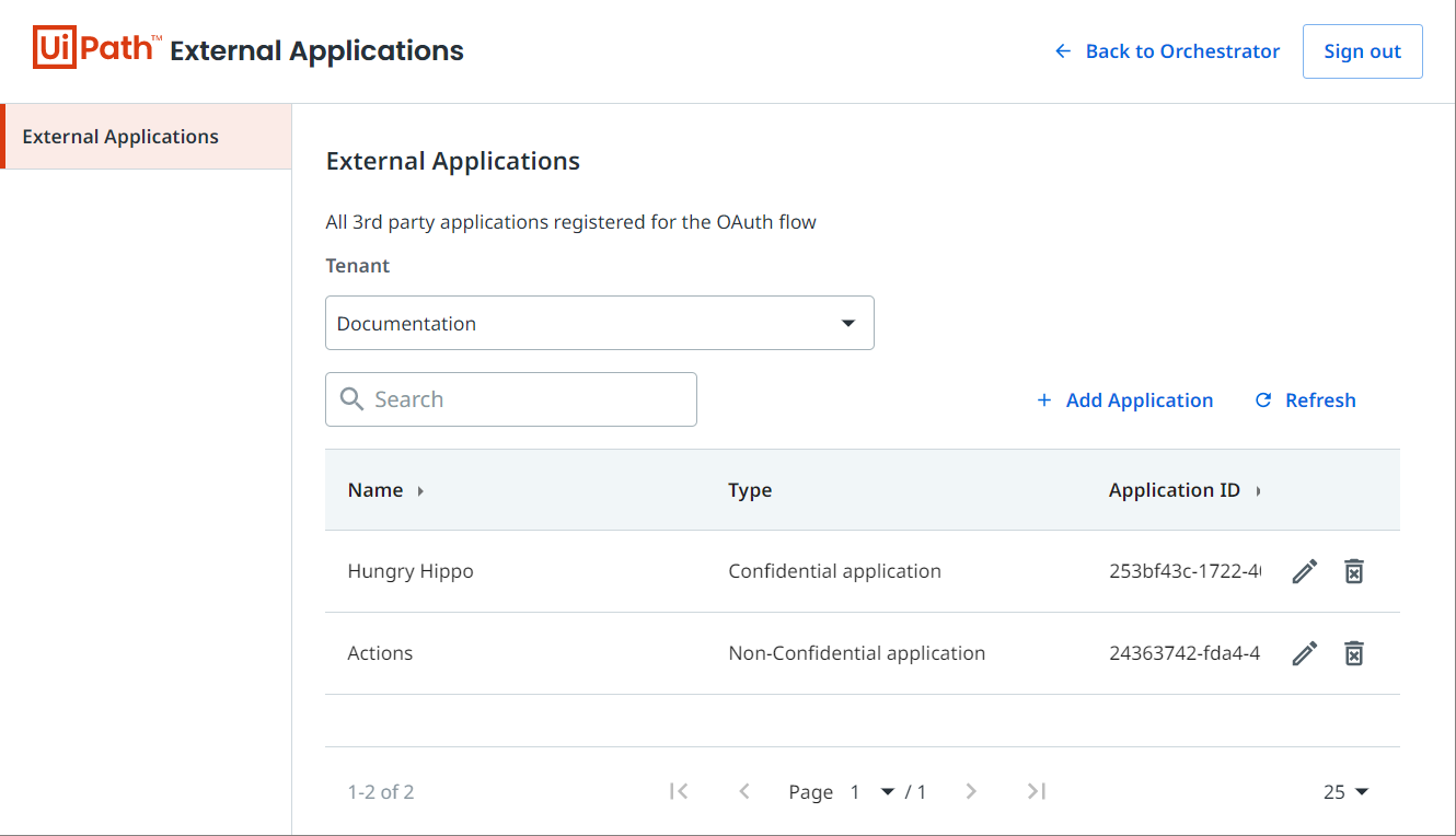

  3. At the bottom of the page, click External applications. The External Applications page opens.
  4. From the Tenant list, select the tenant to which the external application can authenticate.
    All existing external applications for the selected tenant are listed in the table.

  1. Above the table, on the right, click Add Application.
