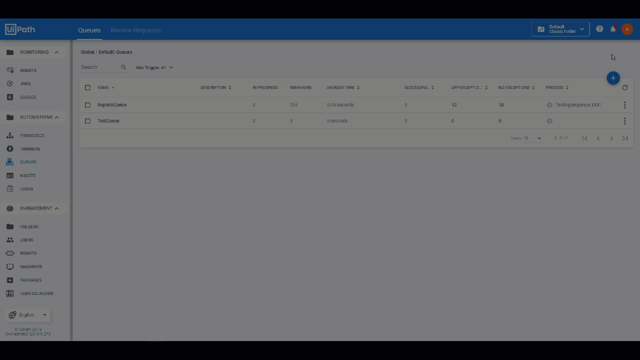

1. On the Triggers page, click Add. The Triggers > Add page is displayed.
2. On the Select Trigger Type section, choose Queue.
3. In the Name field, add a name for the trigger to easily identify it.
4. From the Process drop-down, select the process you want to configure a queue trigger for.
Note: Queue triggers and SLA predictions are interdependent in terms of queue-process association. So whenever configuring one, the other is prefilled such as to have parity between the configurations. Say I define a queue trigger for queue Y to use process X. SLA predictions for queue Y can only be made using process X, therefore X is prefilled and read-only when enabling queue SLA for Y.
5. From the Job priority drop-down, select the priority of the job. The possible values are: High, Normal, Low and Inherited. The default value is Inherited, meaning that the job priority is the same as the one defined for the selected process.
6. (For Modern Folders only) From the Job type drop-down, select the type of the Robot that will run the job. The possible values are: Unattended and NonProduction. The default value is Unattended.
7. (Optionally, for Modern Folders only) On the Execution Target tab, select the rule for the process execution on you Robot(s).
- Select Specific user to execute the process on specific Robots. All the Robots of the selected type in the environment associated to the selected process are available for you to choose from.
 - Select Any user to execute the process as soon as a Robot of the specified type becomes available on machines with multiple runtimes.
8. (Optionally) On the Parameters tab, provide values for input parameters, if your process has any. More details here.
9. From the Timezone drop-down, select the time zone according to which the trigger is to be set off. Please note that the trigger time zone is not dependent on the tenant time zone (configured in the Settings page).
10. From the Queue drop-down select the queue which fires the trigger, if new queue items are added into it.
11. Fill in the Minimum number of items that trigger the first job. This means the item-processing job is only started after the targeted queue has at least this number of new items. Deferred queue items are not counted.
12. Fill in the Maximum number of pending and running jobs allowed simultaneously. This represents the maximum number of allowed pending and running jobs, counted together. For 2 or more jobs allowed simultaneously, the third option needs to be defined as described below.
13. On the Another job is triggered for each __ new item(s) field define the number of new queue items (on top of the number configured for the Minimum number of items that trigger the first job option) to trigger a new job.
14. (Optionally) Select a non-working days calendar, if you want your trigger to stop firing on certain non-business days. More details here.
15. (Optionally) Enable the Disable Trigger at toggle, and enter the date and time when the trigger is to be disabled. More details here.

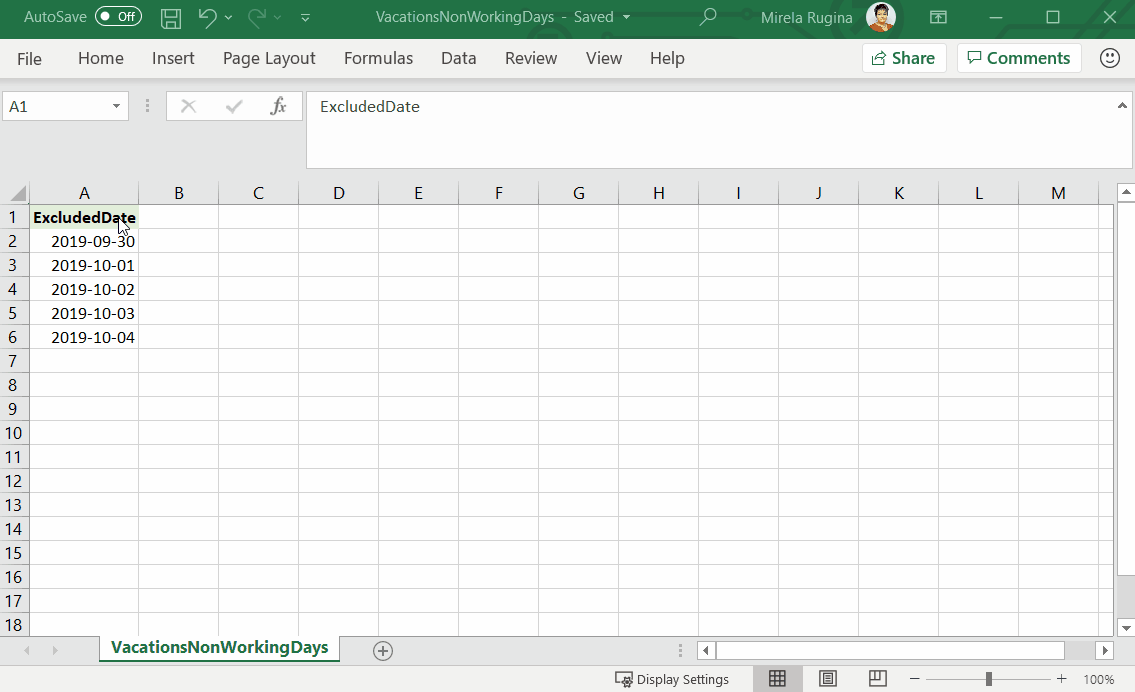

Uploading .csv Files
.csv FilesEnables you to upload a series of dates into a selected calendar, directly from a .csv file. Please note that the file must be populated beforehand using a predefined format so that the upload operation is successful. The new dates from your uploaded file overwrite any dates already contained in the calendar.
Important!
The .csv file must contain
ExcludedDatecolumn header. All the non-working days must be within that column, written in theYYYY-MM-DD,YYYY/MM/DDorYYYY MM DDformat.
Expand the Example section below for more information.
- On the selected calendar click Upload csv.
 - Navigate to the desired .csv file, select it and click Open. Orchestrator parses the file to confirm it meets formatting rules (see the example section below).
 - Click Yes in the confirmation dialog to overwrite the dates already contained in the calendar with the new dates from your uploaded file.
 - Click Save to save the modified calendar.
OR:
- Drag & Drop the desired .csv file over the selected calendar's top part. Orchestrator parses the file to confirm it meets formatting rules (see the example section below).

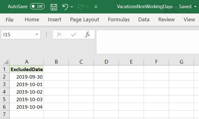

Let's say you upload into a calendar the content of the following .csv file. An easy way to create such a file is to populate the data into an excel file and save it as a .csv file:
Or you can download a .csv file with all the pre-filled column headers and customize it to your needs.
Download file
Notice that this file contains a predefined column header, ExcludedDate. Enter all your non-working days in that column, using YYYY-MM-DD, YYYY/MM/DD or YYYY MM DD format.
